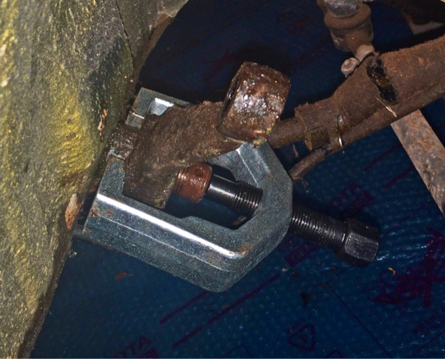

Nut came off after a 48 hr PB bath, and 30 inches of leverage on the breaker.
The arm, however, is still hanging in there, despite a tight pitman arm puller and repeated periodic beatings.
It's sitting, puller mounted and cranked down, dripping in penetrant.
I'm waiting for a clang/clunk sound to come from my garage.
It will go, eventually....trust me! :D :D :D :D
Every time you pass by the vehicle, see if you can tighten the puller just that little bit more, then all of a sudden (at some stage).............there will be a BANG!

Profpinz wrote:.......there will be a BANG!
Maybe if everyone sends good vibes through their computers/devices, all the positive energy will bust it loose.
Or, I'll use that big a$$ breaker bar on the end of the puller bolt.
Whatever works.

Just remember you really have to "load up" that puller bolt......tight as you can get it! :D

As Peter said but I would add a bit of heat - where it is is not going to damage any steering box seals - screw that shaft as tight as you can - heat - screw - heat - screw - bang - cool - cool - cool
