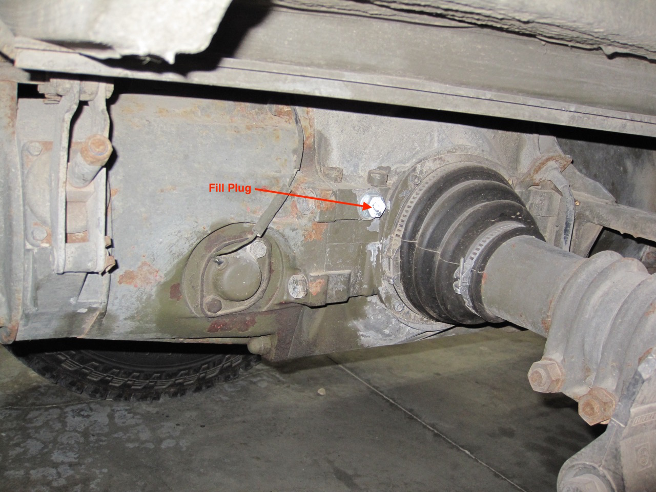

There are 3 plugs on the rear diff: the drain plug on the underside, the fill plug above and in front of the switch cover and the level check plug which is somewhat hidden in front of the axle. The procedure is to fill gear lube thru the fill plug until it begins to flow out of the level check plug. When it does the lube is at the correct level.
The level check plug and the diff indicator switch are at the same level on the differential so you may have some gear lube come out when you remove the switch if the diff was overfilled. But you shouldn't have to add any gear lube unless the level is below the hole the switch was in.
Here's what a new switch looks like: Over time I've found that the plastic insert portion of the switch becomes loose and allows gear lube to leak out which is probably why you found lube under the switch cover.
Good luck!
Good luck!

Wow really incredible pictures. Thank you that! Exactly what I was looking for.
