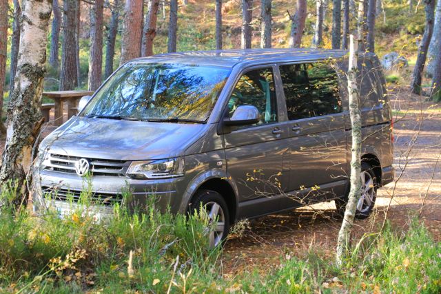

So with my Pinzgauer sold the gap has been filled with a VW T5 4Motion
The plan is to make it a true multi purpose vehicle with the ability to carry two mountain bikes internally, sleep in and carry all expedition gear. The vehicle is deliberately on-road orientated with no suspension lift and at this point no extra under body protection. It is however four wheel drive using the haldex system found in many soft-roaders and high performance four wheel drive road cars. I had hoped to find one with the rear mechanical diff-lock but this one ticked all the boxes with spec and doesn't have the diff-lock. My car (Skoda Octavia Scout) has the same haldex system without diff-lock so I'm fully aware where it's limitations are. The tyres are all-season and have the snowflake symbol so count as a full winter tyre. I have a set of steel wheels as well so may save them for a more aggressive winter / mud tyre.
In Iceland we were impressed just where these 4Motion T5s were able to get so I'm sure this will enable us to continue to explore remote rough tracks as well as eat up the motorway miles much quicker and quieter. Still miss the Pinz of course.

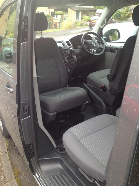

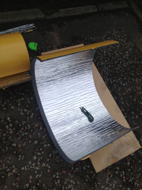

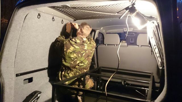

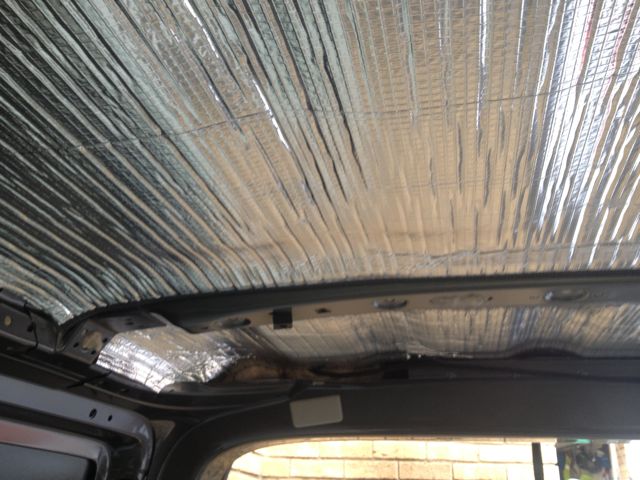

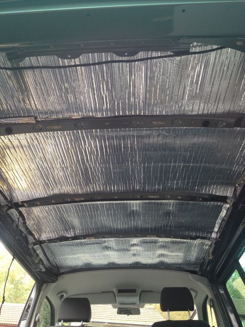

The conversion has started. A swivel has been fitted to the passenger seat so that it can be swung around to face the back when camping. This will allow two people to sit opposite a table whilst freeing up the rest of the space for the bed and storage.
Most of the work though will be hidden. Insulation is being added behind the panels to reduce condensation and noise. The insulation is special foil faced closed cell foam with a high temperature adhesive backing. Small spaces are filled with a sheep's wool based loose insulation. I am also having additional power socket and USB charge points put in the back of the van.
The plan is to replace the panels with custom ones including storage pockets into the panel space. These I have yet to fabricate.

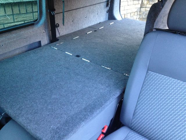

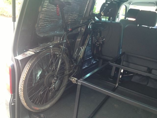

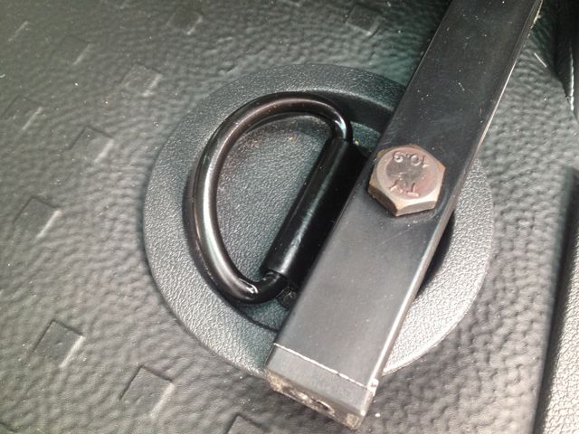

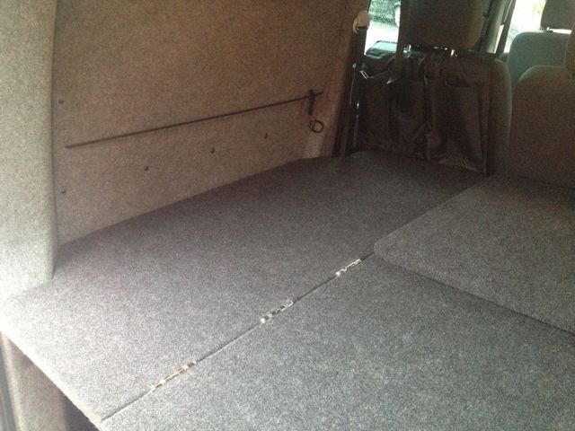

Work has continued on the van. A bed platform has been constructed bolted into the existing cargo tie down points and the sides carpeted and cargo D-Rings installed. The bikes will fit even with the bed in use.

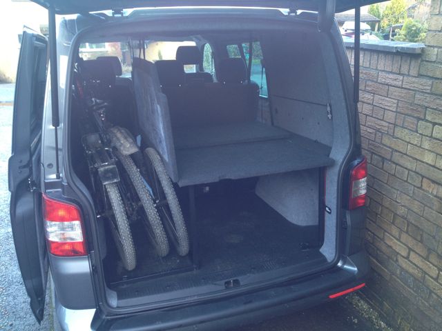

The build is nearly over. Of course over the coming year I'm sure there will be several tweaks as we use the van and see how it works in use. The bed platform is carpeted and fits perfect. As planned part of it can be folded up, still leaving room for the mattress, and two mountain bikes can be fitted at the side. Getting the finish as neat as this has taken time but I'm really pleased with the results. Looking into getting a Webasto heater fitted for the winter.
