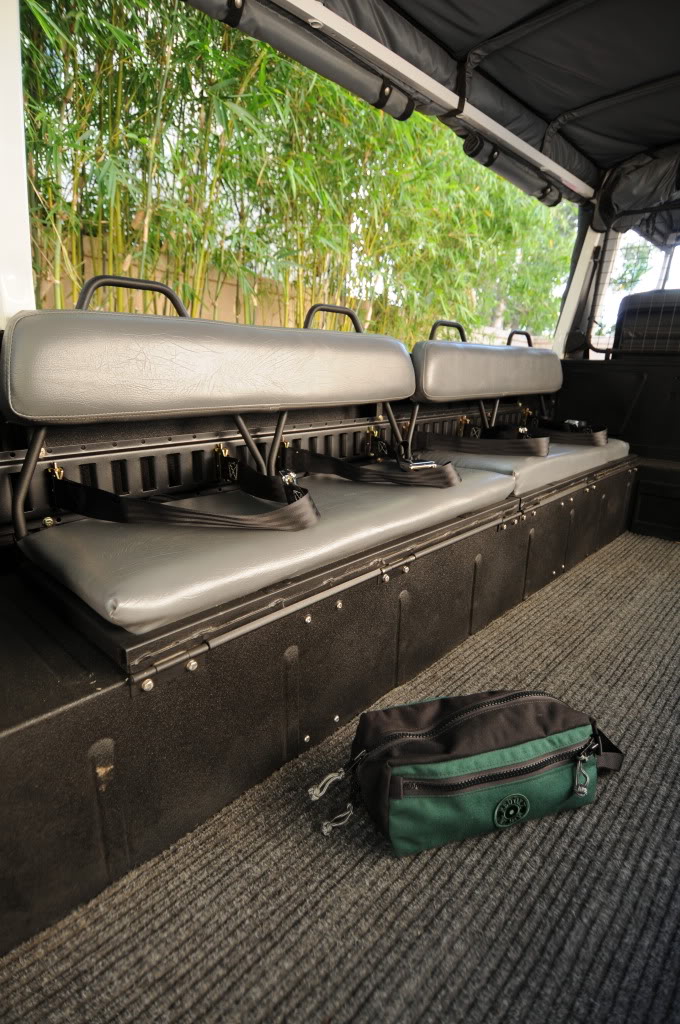

E-trac is a steel track that the seat belts (also cargo straps, etc.) lock in to. E-trac is available here: http://stores.ebay.com/Mackie-Enterpris ... c=1&_sop=3
as well as many other dealers.
I remember a few old threads on the forum about installing seat belts using e-trac. A search should turn them up along with some photos.

Here are a few links and some pics for you:
E-Track (proper): viewtopic.php?f=17&t=7541&hilit=seat+belts
Direct bolt in (don't use retractable and sheet metal may be to thin?): viewtopic.php?f=18&t=7178&hilit=seat+belts
Check out seatbelt planet for regular belts (EI for E Track belts: http://www.expedition-imports.com/produ ... -BELT.html)
In photos below only 10 bolts are holding the thin E-Track in (see the EI post above on how to do it 'properly')
There are also other options but E-Track seems to be the popular choice for Pinz owners
Andre
Posts: 973
Location: Winnsboro Tx
Re: Rear seat belts wanted
Post by Andre »
Brian Mason did that truck. Therefore, It is as "proper" as it should. Only tour rigs need more than those 10 grade 8 bolts and nuts.
Andre wrote:Brian Mason did that truck. Therefore, It is as "proper" as it should. Only tour rigs need more than those 10 grade 8 bolts and nuts.
Brian didn't install the E-Track that was done by owner at the time (Gear/Justin) - just sayin'

I installed e-track and the EI belts in my 710m. Easy project, works great.
The only downside is that the belts clank around a lot when not being worn.
