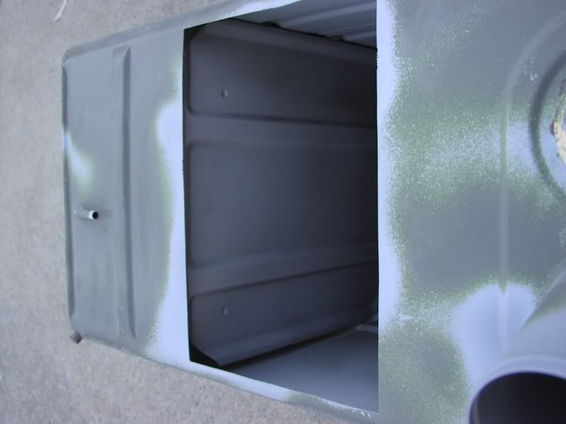

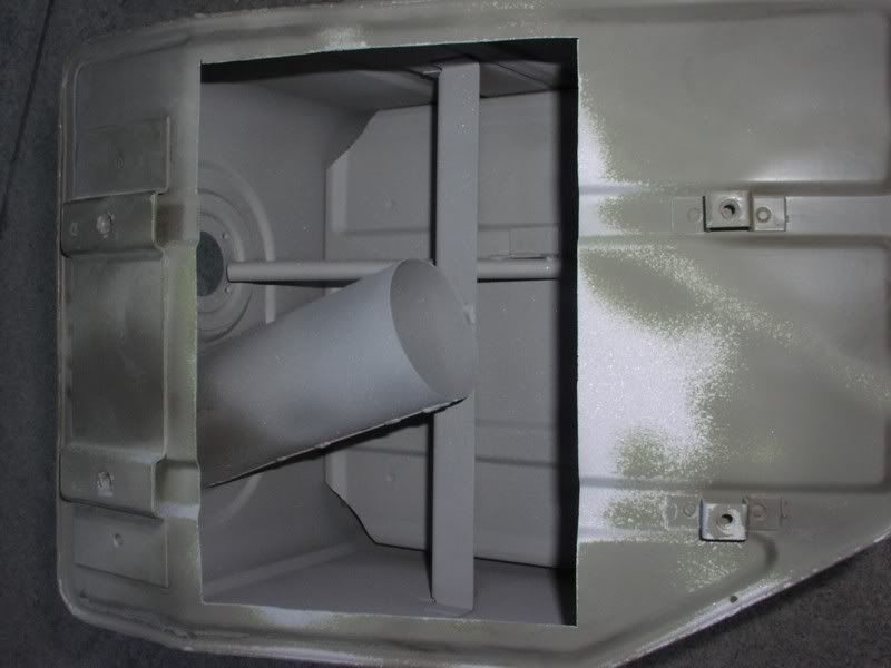

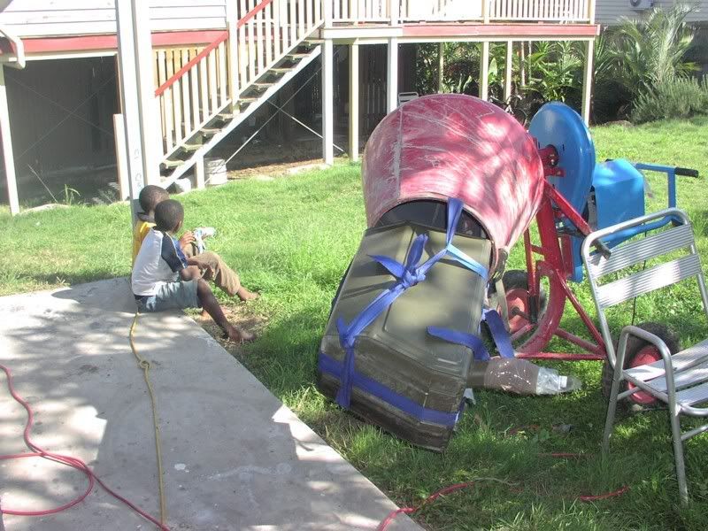

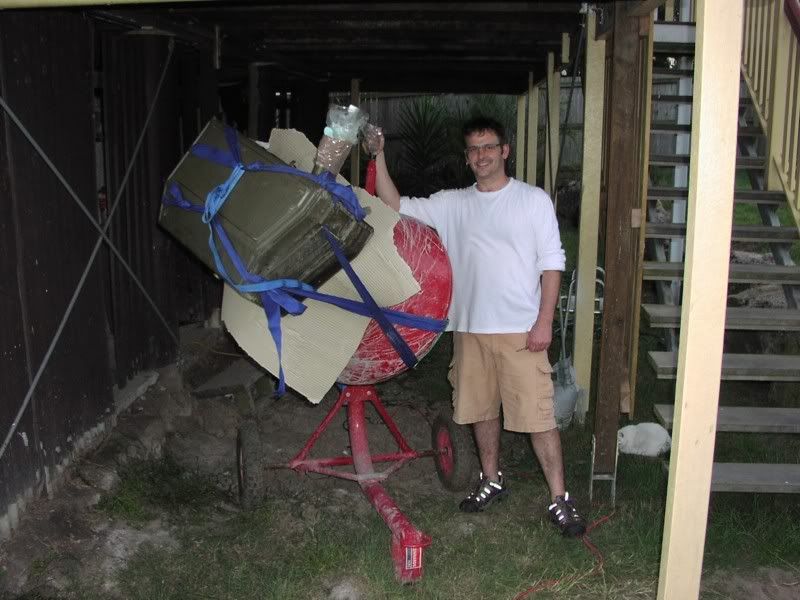

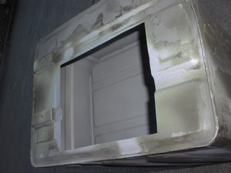

I have recently recovered from the Read Death so it is fresh in my memory. I just got my Carbs Re-Built by an old guy up here in Brisbane who specialises in Zenith Carbs and I drove it home from the shop and it ran like it never had before it was perfect. After I got home I looked in the box of goodies that he had left me and I found a fuel filter. Funny I thought I have only just changed that, and then I looked at it closely and the Red Death was there. Rather than Stuff up my pristine carbs I got straight into it following the instructions I looked at on the SDP website under Technical Section, Body, Fuel Tank Liner.
First of all I tried Caustic Soda and Red Hot water (as it is cheap) but that did not touch the lining it at all. I then plugged all of the holes well and filled it up with 5 litres of good quality paint stripper, coins and nuts and bolts and all sorts of stuff. Rather than shake it by hand I thought I would be a smart arse and borrow a cement mixer to do the work for me. See pic me pleased with myself. Little did I know!
It was noisy but after I had had a few beers I hardly noticed it at all. I changed its position regularly and let it run for many hours (almost all weekend). I flushed it well with hot water and took all of the plugs off and shined a torch inside. Most of the Paint had gone but to my dismay there was still a lot left probably 25%. Mostly in areas where the shrapnel could not reach. Pretty pi**ed off I wondered what to do next. I worked in the furniture industry for a while in England and we used a stripper that was imported from the good old US that was truly unbelievable. It is used for stripping aircraft and ships and hardcore industrial stuff like that. Benco from Crossville, TN is the company. This stripper is amazing and I would have given it a go if I could have got it in Australia but I would have had to order a pallet load! Below is a link to their products. I think the B14 is the best as it has the highest Methylene Chloride content. You can get enough to do your tank in the US for USD$61.95.
http://bencosales.com/store/index.php?cPath=63_65
So I cut 3 holes in the tank and could see the baffles inside properly. There was a lot of paint in the end section of the tank as the gaps down the side of the baffles were so small (see pic) that the nuts and bolts could not find a way in (or out) there very well. I had the inside sand blasted for $30 dollars and welded for $80 and re coated the inside as per the original instructions. I have touched up the paint and it looks fine. My only concern is if it takes a real whack the welds may not be as strong as the original design but time will tell.
Sorry it was a bit of an epic but in short if I was in the US I would buy the Benco stripper (just be careful with it, it is strong stuff). And if that did not work I would be getting my hacksaw or my cheque book out. Leave the cement mixer for the driveway!
